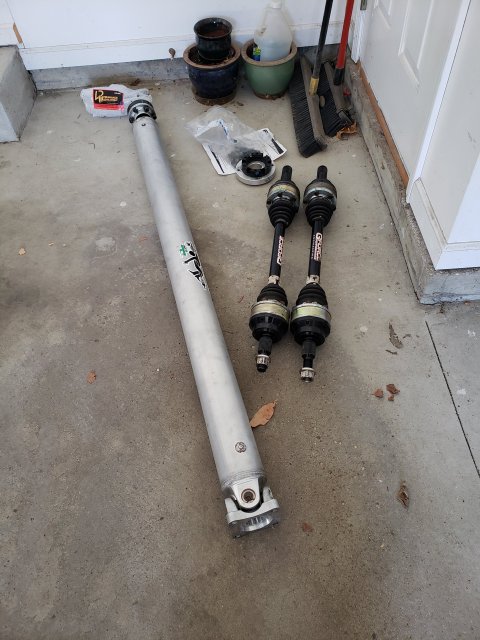

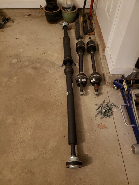

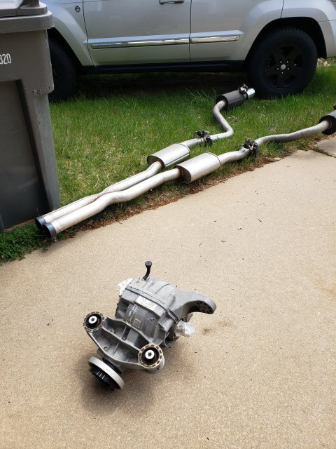

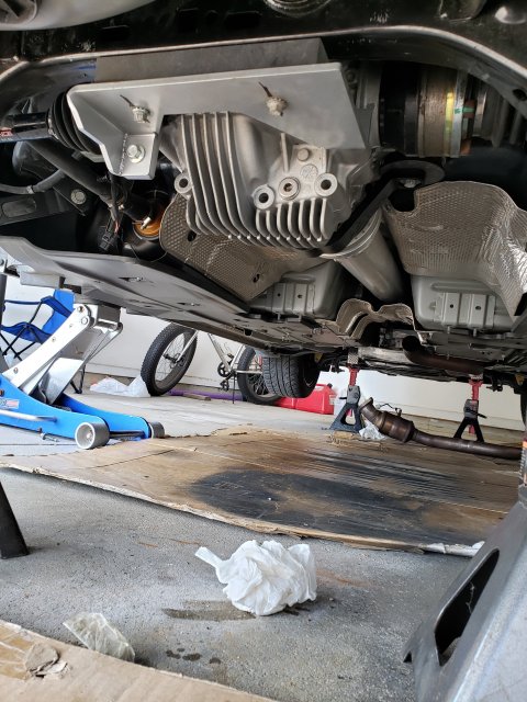

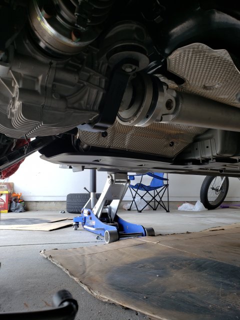

So today I decided to install my 3.09's which I bought used before I even owned a Hellcat because I thought I may want to try them. They only had 1500 miles on them. I picked up a used DSS aluminum driveshaft last summer and a few week ago bought some Gforce axles from the same guy I bought the rear from. Doing them all at once makes the most sense being they are all connected. You have to drop the exhaust for the driveshaft and rears and doing just the axles you have to disconnect the arms and brakes. The axles are only held on with one nut and come out the center so with no rear in place they come right out without taking the other stuff apart. Took the driveshaft off first then the rear and the axles. Reverse back together and also add the front brace. I started around 10 and Nick didn't make it over until 11:30 and we were done around 4. So 6 hours, probably 5 if he would have been there at 10

Wait you do have a Per4mance Brace right?

Yes in the pics. I'm planning on upgrading to the DIRS
