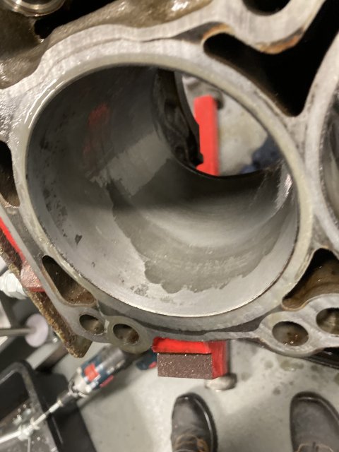

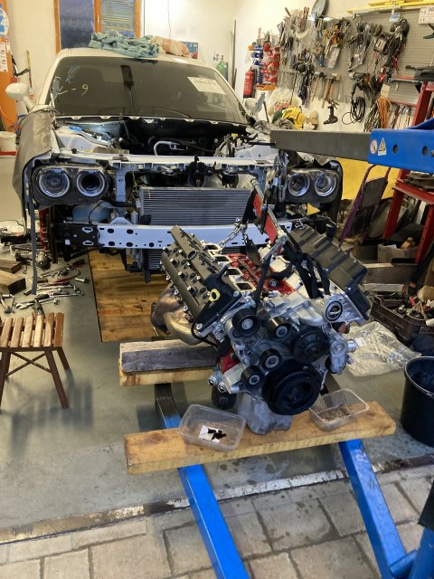

Hi Everyone!
I am Tamas from Budapest, Hungary.
I would like to share with you my current Redeye Hellcat build.
The background: I got last week my Redeye delivered. It's motor has sucked a lot of water.
I have already taken it apart.
The supercharger survived, and the heads, cam, lifters, are good too. Crank is at the shop for crack investigation.
Unfortunately at the insurance field the car has waited more than 6 monts with water in the combustion cylinders.
I have now issue with the engine block, because the water has corroded the cylinder walls.
The machine shop will try to hone, but I am not sure, how the result will be measuring (whether would stay in tolerance)
Has anybody faced with such an issue?
I would appreciate any help, suggestion or suport on parts, or methods.

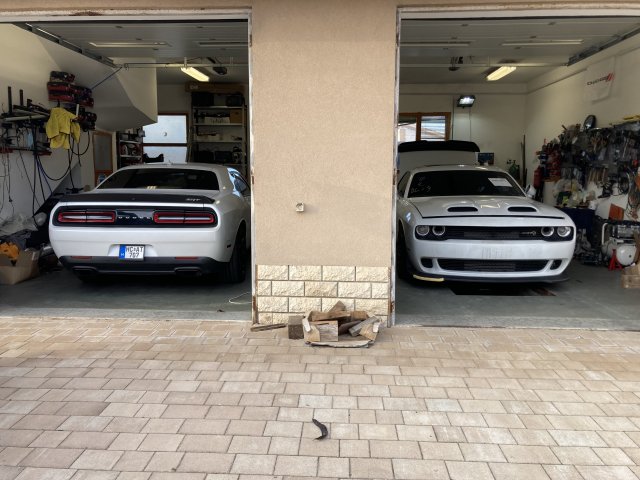

Welcome to the forum.
WOW, Nice to see your shop and work you're doing. Amazing to see hellcats in other countries. Sounds like you are on top of the issues, and I wish you the best on your journey! We in the USA often don't think about how hard it is for others to simply get what we can walk into any dealer or shop and find parts in a day or two.
Thank you!
Yes plans are depending on possibilities too. In the US, most probably I would look for a new short or long block from MOPAR. Currently the delivery and the additional costs are almost the same as the new engine itself. Maybe it will be the solution anyway.
1,469
3,700
Welcome! I love the license plate ;-). Best of luck with the project! Lots of smarties on here.

If the cylinder is visibly bad, I wouldn’t have a lot of faith in the hone and be ready to bore it out. If it hydrolocked you may need a rod or two, so getting rods with oversized pistons would be next.

Thank you for the hint. I am also not confident on honing, but I give a chance , ca. 150USD is the machine shop cost. If it is successful, then good, othervise waist of money and time. I have found 1 bent rod. It was I think in low RPM range at the time of hydrolock event.
