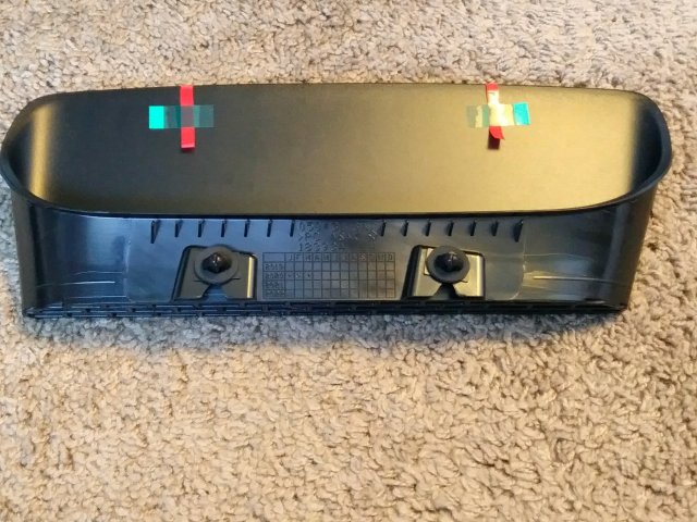

2020 HELLCAT HOOD Scoops are 05043113AB LEFT, 05043112AB RIGHT

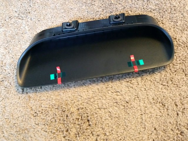

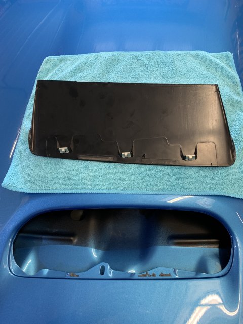

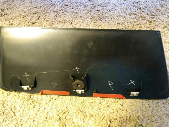

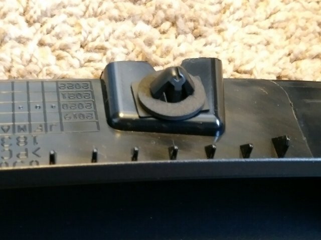

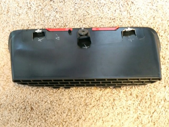

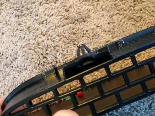

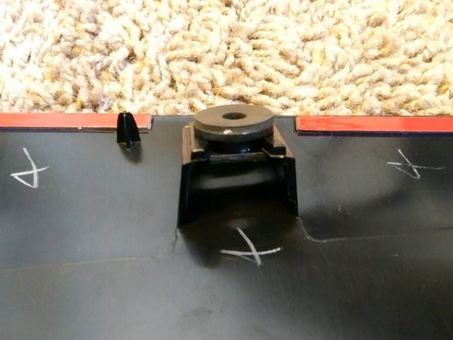

Here is a 19 hood scoop removed. It has the same 3 clips that clip into the 3 flat areas in the sheet metal at the bottom and the locating pin and corresponding hole in the sheet metal. All same as 2020 below it. If installing a 2020 scoop in a 19 all you have to do is make sure there is enough room for the nutsert to clear, otherwise remove it. This should also make it clear a 19 scoop should fit a 2020. If you look up the different scoop part numbers many sites show the scoops fitting both years. So I ASSUME they will interchange. I guess it’s possible the shape is different but it appears not. I went with a 2020 scoop because I want to use the nutsert provision and it is not much trouble to remove the grille.

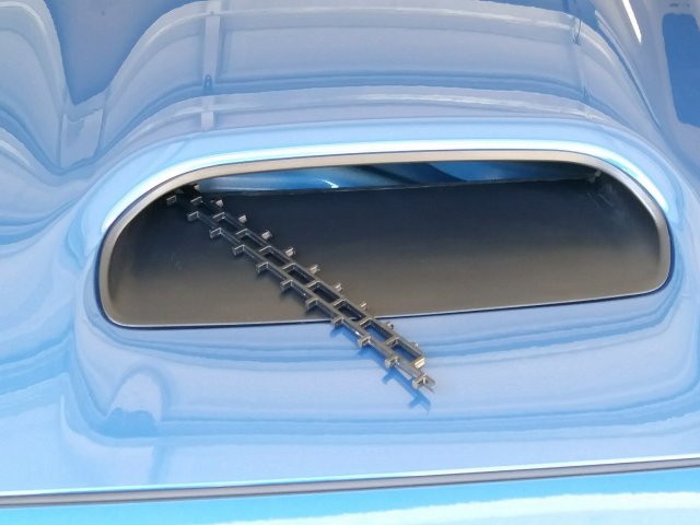

Interesting.. my driver side one was loose the other day too.. front came up a bit.. I just pushed it back down into the clip and it’s been fine Since.. definitely like the look without the grille bit in the bezel.

The '19 bezels come loose/pop up when you shut your hood if the double sided tape is no longer holding,
