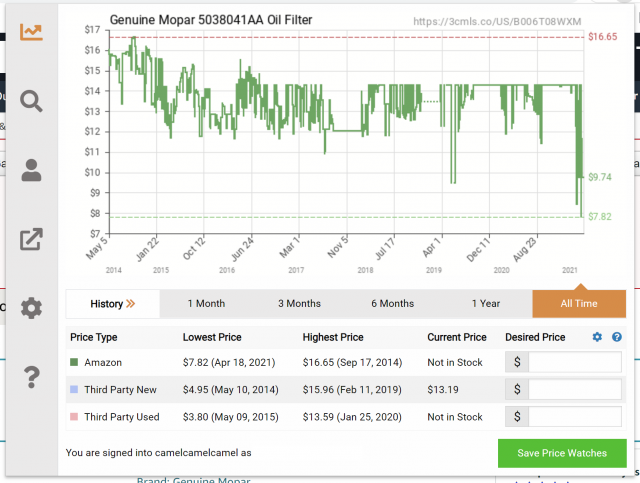

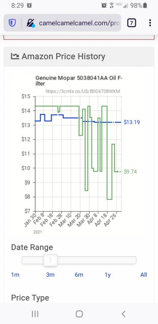

Sweet buy, who doesn't want a used filter. A month ago I saw some oil for sale on amazon that said 'Barely used' should have picked up 50 gallons of that to.
Yes, I prefer my oil & filters be broken in on someone else's engine - none of that really slippery, clear stuff & dry filters for my cars !
