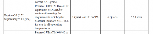

#56
FSM states 6 quarts for 2015-16 cars.
