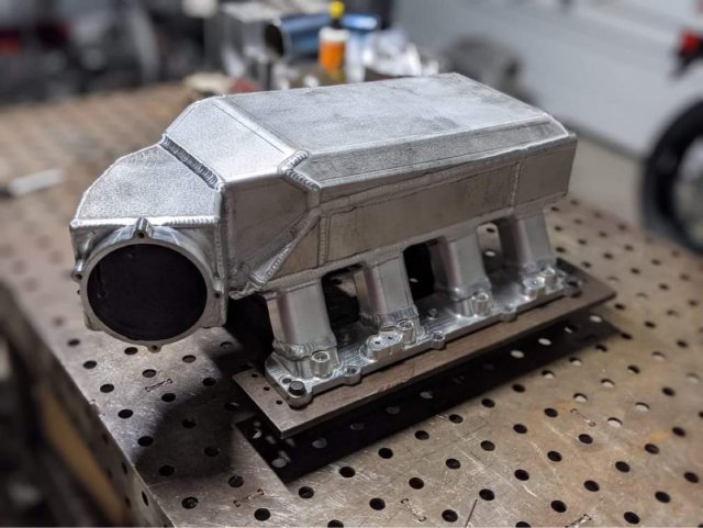

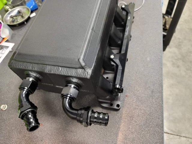

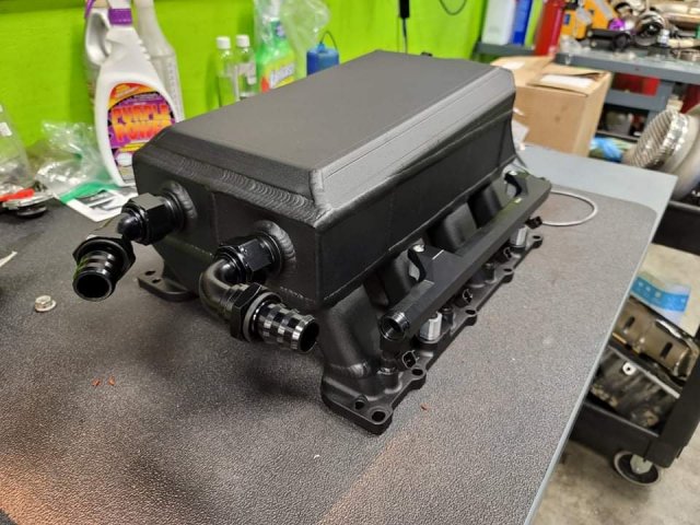

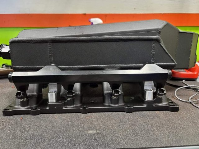

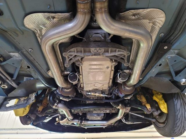

F11DA7AF-03EC-411C-A2E7-6AD6E09ECBD8.jpeg A987D3C0-3C2B-48F1-9F40-045267C1321E.jpeg 65F11F98-D3AE-4936-9E6C-53B7A9FD6CDD.jpeg 32B9E715-02FB-4870-8448-EFA1BA2E763D.jpeg

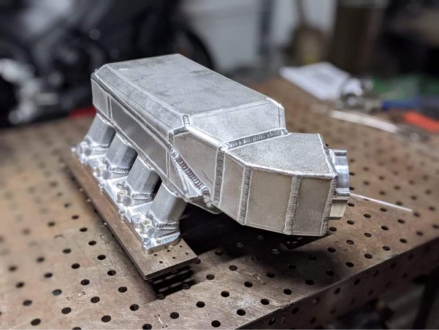

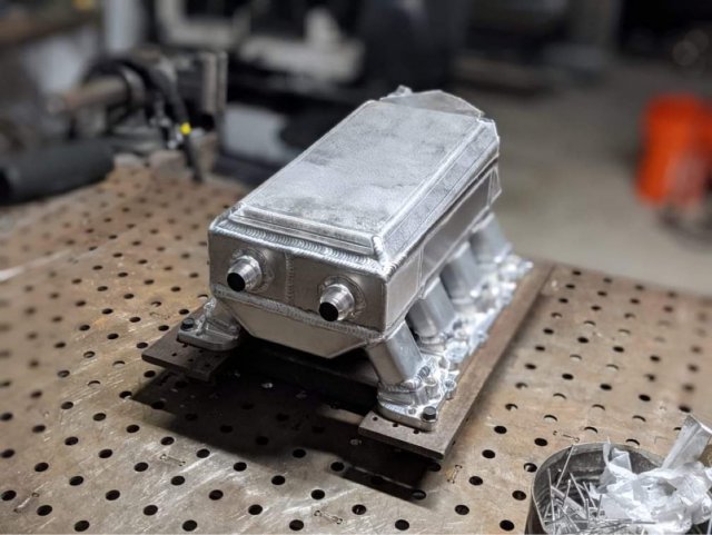

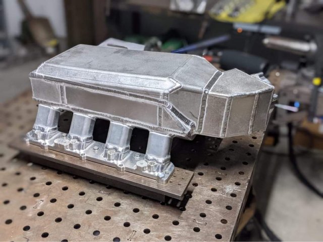

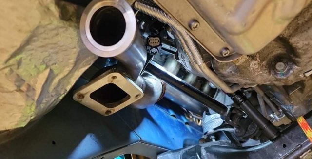

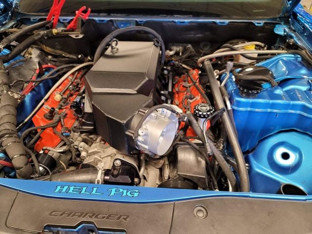

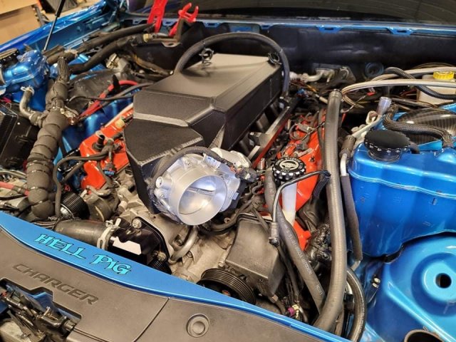

Some progress…. 1F25E44F-1CBE-434A-A592-F9F9368CF950.jpeg 97DB233B-B689-4D74-B73B-F35C42A4D72E.jpeg 52EC90CD-AC8F-4164-9097-EBC9EBF709DF.jpeg 85C68672-95A5-4001-86AA-CAFAA9327A44.jpeg C6C816A7-1CF1-48CA-BC6C-EC4694166273.jpeg

I’d say another week hopefully. Had to order a stock sized ATI balanced due to the 10% not working with their oil pump adapters and not being able to get the hub off lol. The plan was to put the stock balancer back on, but we don’t want to beat on the crank that much. That should arrive tomorrow. The rest is piping, intake, and some wiring.

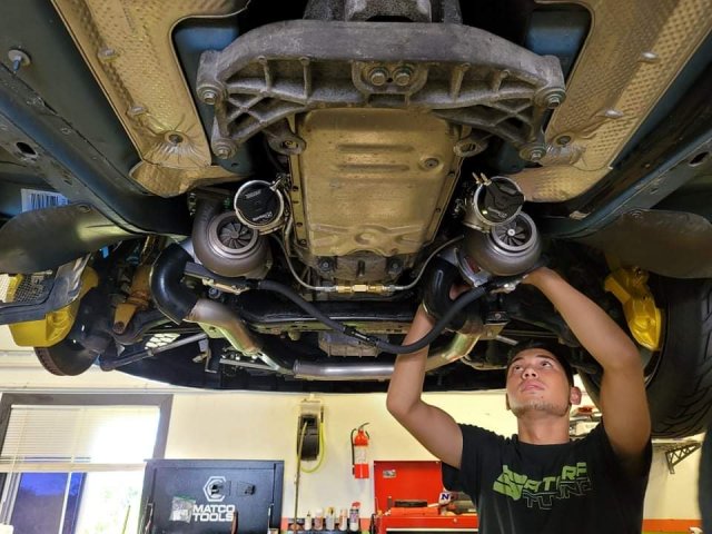

Being you daily drive yours do you worry at all about water and the turbos being underneath when it rains? I'm not sure how they protect against that.

No, they are tucked up right next to the trans for the most part and use filters. I’ll provide pics when I can.
Low mounts are FINALLY being accepted in the turbo community. For years they were shit on because there was only ever 1 place to put the turbos… but they’re finally seeing the light. Having a turbo right at the collector is a million times better than after 10’ of mild steel piping to put it somewhere more visible.
Turbos are made out of very durable materials (cast aluminum and cast iron or steel) for the most part. So long as you’re not sucking rocks into the impeller you can put them wherever you want. Oil pumps have come a long way, and in the last 10 years or so people have finally figured out how to manage returning the oil to the pan without relying on gravity.

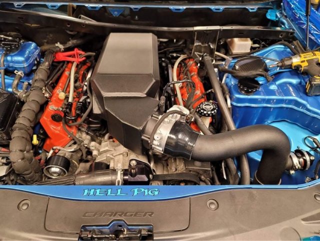

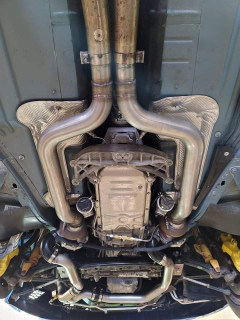

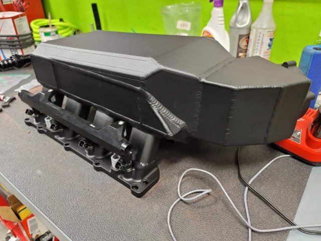

0735CA15-E0C4-4A74-BC02-F8FD9C43D345.jpeg A1959457-B685-464C-954D-F0608F2F0B0E.jpeg

5F69F767-4320-4FDA-9CBC-794B4B499E81.jpeg 94319881-2259-47AA-B632-8A357A17E4A8.jpeg
