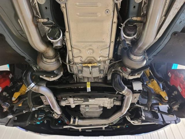

After being an S/C guy my entire car life, I’m venturing out and trying turbos. It’s my tuner’s “wheelhouse”, which swayed me easier. I had a target of 8.9 full weight on my current setup and I believe I would of hit that this fall without issue. I’m looking forward to learning the car all over again. Launching will be the biggest hurdle to dial in to equal / better my current ET’s, but I’ll get it.
I’m going with a Hellion kit with 6466 turbos.
I’m also going to use this Goertz1 air to water intake that will run off the coolant tank under the hood and be chilled by my FI
interchiller.
It will also have a two-step, which will be another fun toy to play with. I’ll be able to leave on a couple different low boost settings to hopefully mirror the launch I’m used to now.
The setup comes with an electronic boost controller and I’ll have various power settings available at the tap of a button all while retaining my flex fuel setup. Boost setting “1 and 2” would be safe for 93 or e85, boost setting 3, 4, 5 would be good on pump e, but not 93, and then boost setting 6 would be an e90 pure race dedicated only.
I’ll be making the move early August. I’ll provide updates, pictures, etc. as the process goes along.

I’m targeting similar power to now, but on about 5 less psi. That will be the every day setup and we’ll see how it goes being bumped up from there.

That is what I look forward to. Can neuter it or go full kill in seconds.

Dave, the hardest part is going to be getting the launch to hit like it does now, but in a less aggressive way. If I can mirror 1.3x 60’s, it’s going to boogie. I have a demon converter (forgot what it stalls to), but I may have to go a little bigger if we can’t get the two-step to handle it for me. I’d hope to build a couple psi off the foot brake, but at least 6-7psi with the twostep. That would give it the “low timing” like launch it has now, but with a more killer top end.
