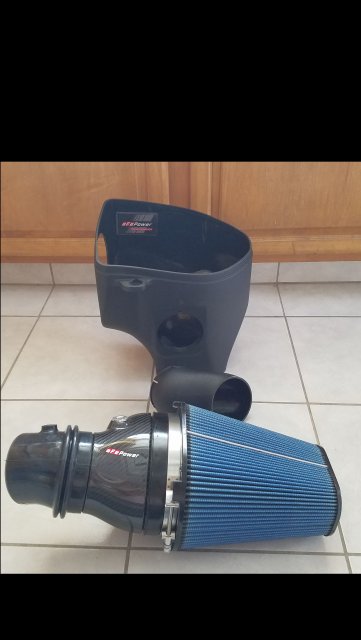

I will be switching to a Demon hood (carbon fiber) now that there is an aftermarket airbox setup available. I bought the AFE Demon airbox setup, and I have to say it looks very well made.
Comes complete with everything required to work with the cold air intake Demon hood.
I will make this change in a month or so. We will trim the lower portion of the airbox to clear my steering.
