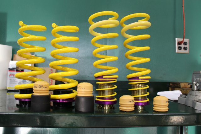

I went with KW adjustable springs and over 30K miles later still real happy with them. I like you can dial them in to the height that suits your fancy. Dropped mine a fuzz over an inch. I did go through CV boot tear problems until I swapped out for Redeye half shafts. So far, so good. Ride is similar to stock but does corner much better. Also will not affect any of the adjustable suspension options. Just have to remember your stock shock travel will be reduced somewhat. I also installed a Bwoody kit, in back, to get the neg. camber dialed back in to spec. Camber bushings will work for a little less money though.
I do a hybrid with the KW’s. Have the KW’s up front at about stock height, but they are superior in their specs up front. Retained the OEM springs in the rear because the OEM is stiffer in the rear and I don’t want to lower it. I like it. After several years the darn fronts need tweaked once in a while because they want to drop a bit. Just glad I can keep doing it.
Luckily the fronts are the easy ones ;)
Forgot to add.
Also got boot tear from the eibachs
